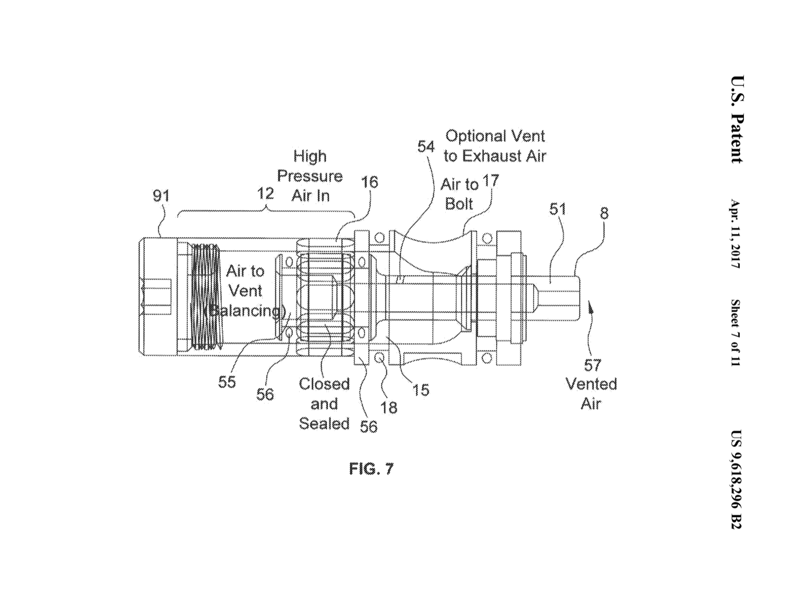

Name:	Screenshot 2023-10-07 at 4.02.47 PM.png

    we can all see where the idea came from

    Grease it initially and leave it alone. This is a highly reliable design.
  • imped4now
    commented on 's reply
    Given the opening and closing dynamics, the pressure requirements will be based primarily on flow. It should be able to run quite low.
  • imped4now
    This isn't an old unreliable design. This thing will work great.
  • imped4now
    Current Dye shares very, very little with old Dye. Billy is no longer leading the design charge, thankfully.
  • imped4now
    There are differences.
  • imped4now
    The valve seat is a 90 durometer 011, a common seal. The U-Cup is a 008 spec ( I've never come across a U-Cup that isn't 70 durometer, paintball or otherwise) and I believe the end seal is a 6x1mm. I'd need to verify that one.
  • imped4now
    That's a wide open question, seeing as the closing dynamics are no longer pressure-based.

    Looked a little more like a balanced Timmy valve to me, but yes... very morph- like, too.
  • Magmoormaster
    My thoughts exactly
