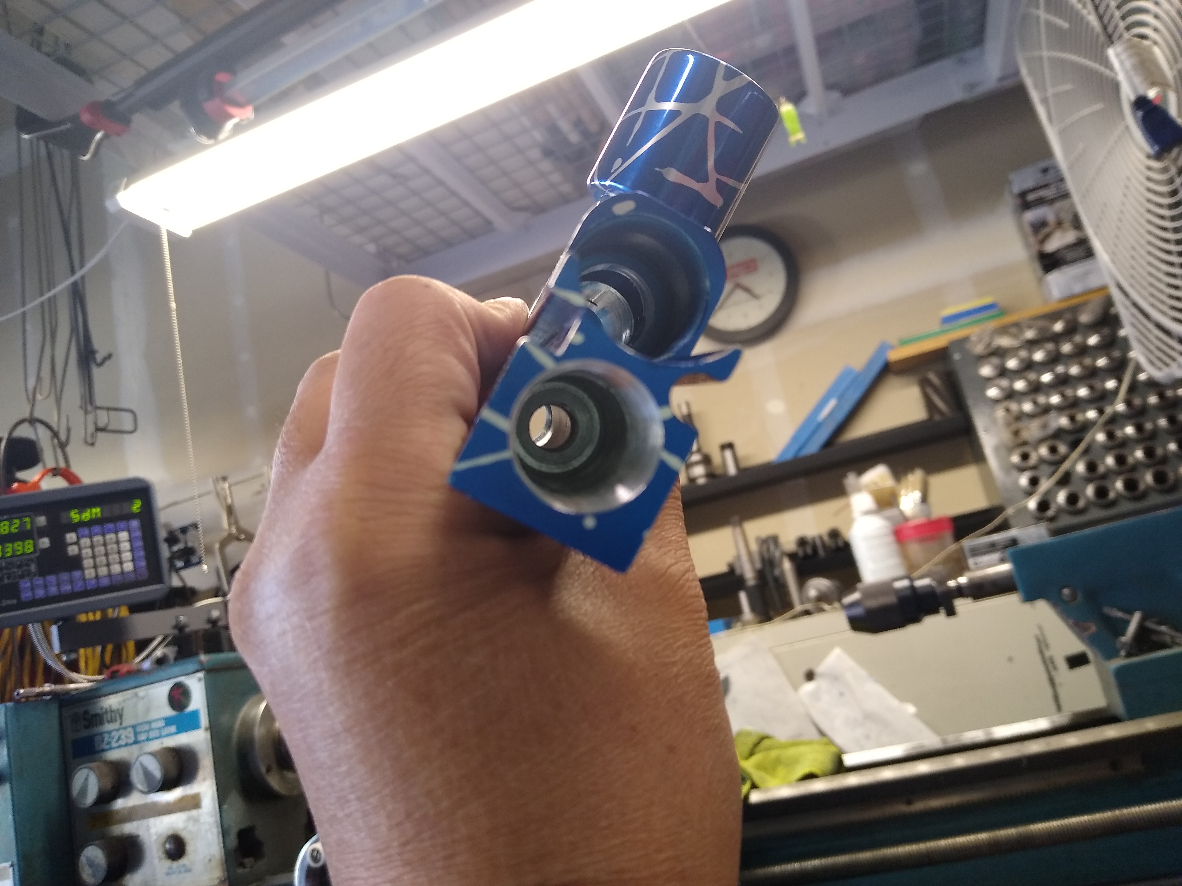

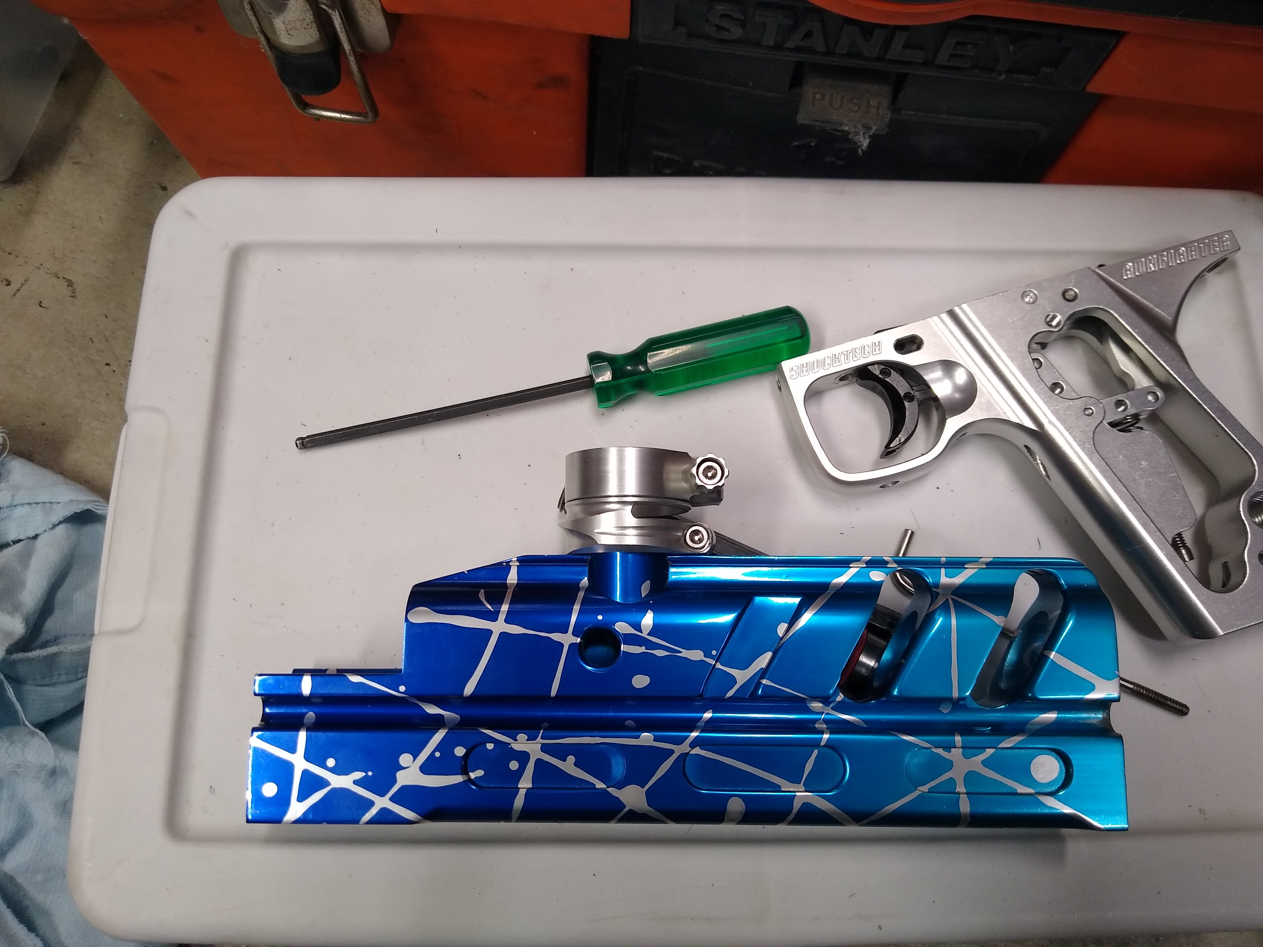

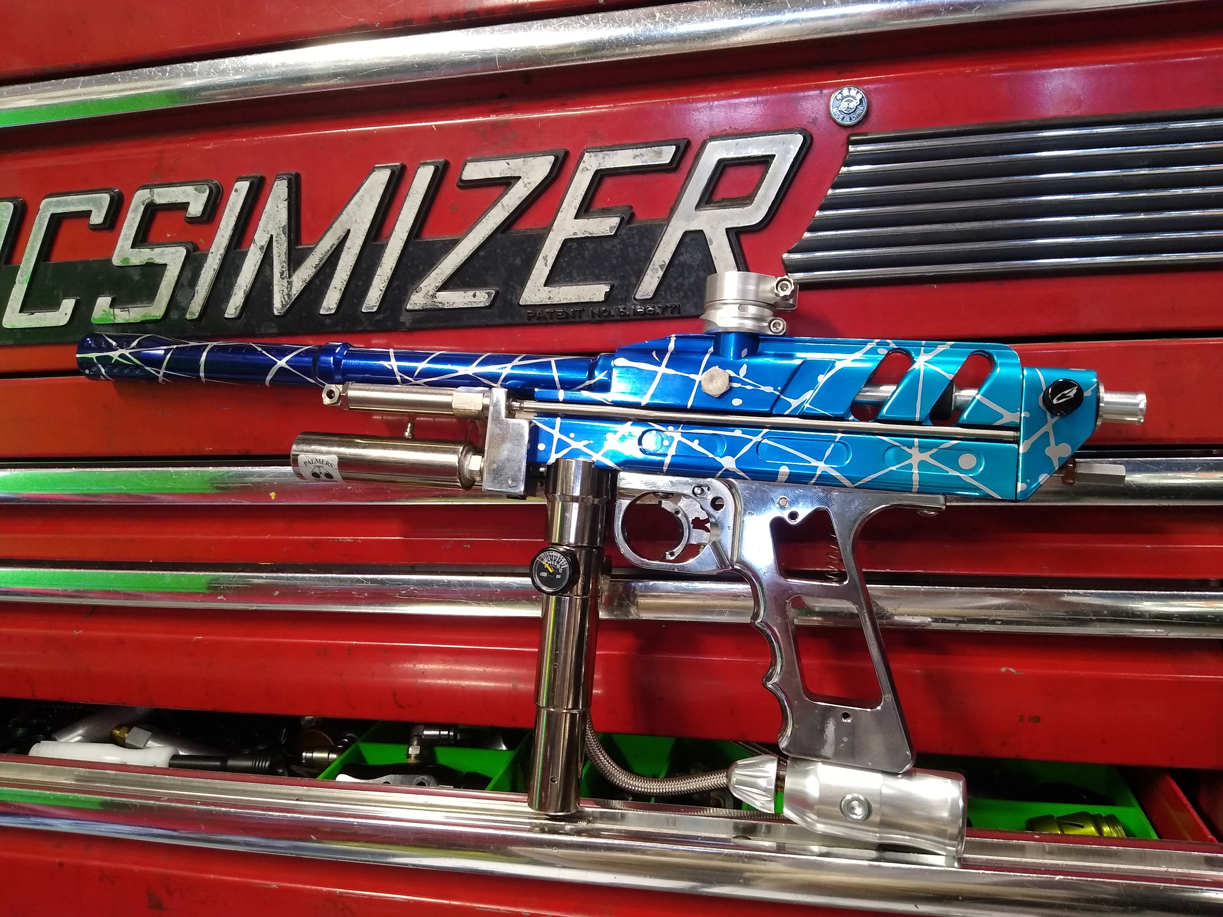

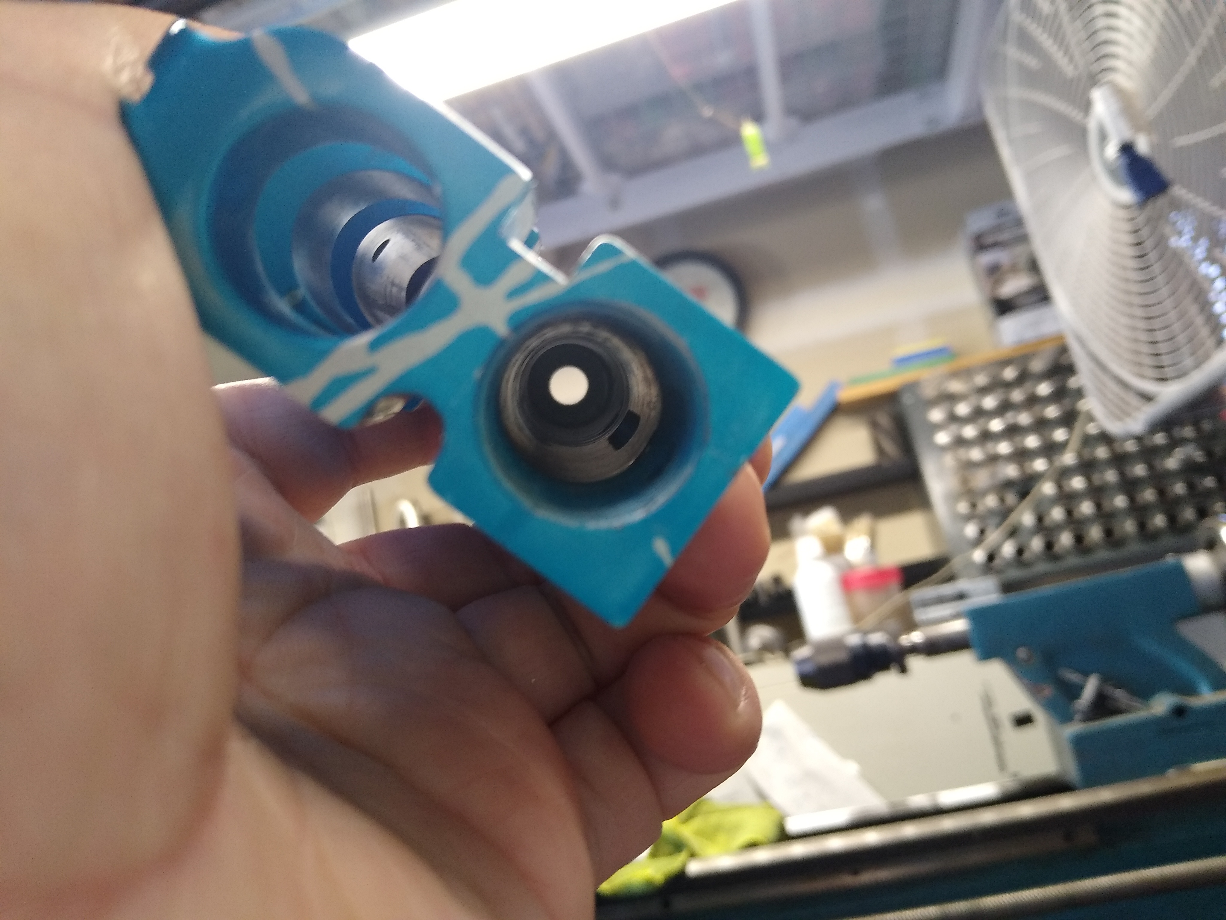

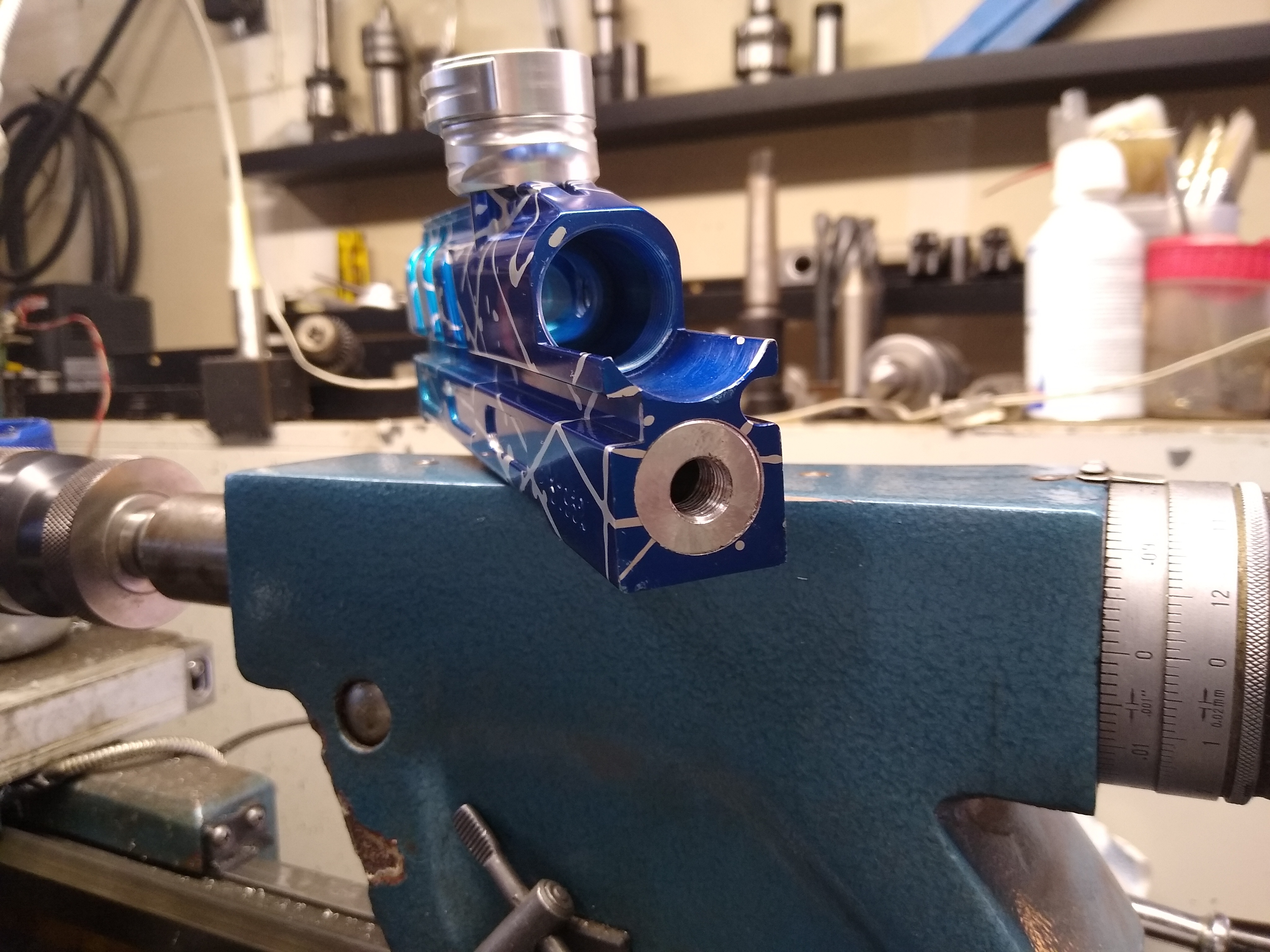

    So I drilled and reamed the lower tube of a pre 2k cocker I have. Plugged the front so I can use the original front block.
    It's shooting 320fps at 230psi with reballs. I'm running a delrin hammer from the morph valve and blue madman hammer spring. I'm getting a little bit of farting but that's the lightest hammer spring I have.
    Who makes the lightest hammer springs?
