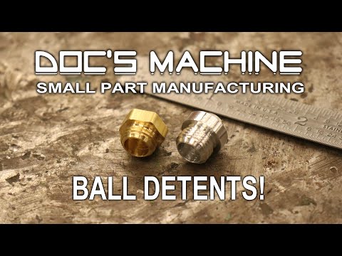

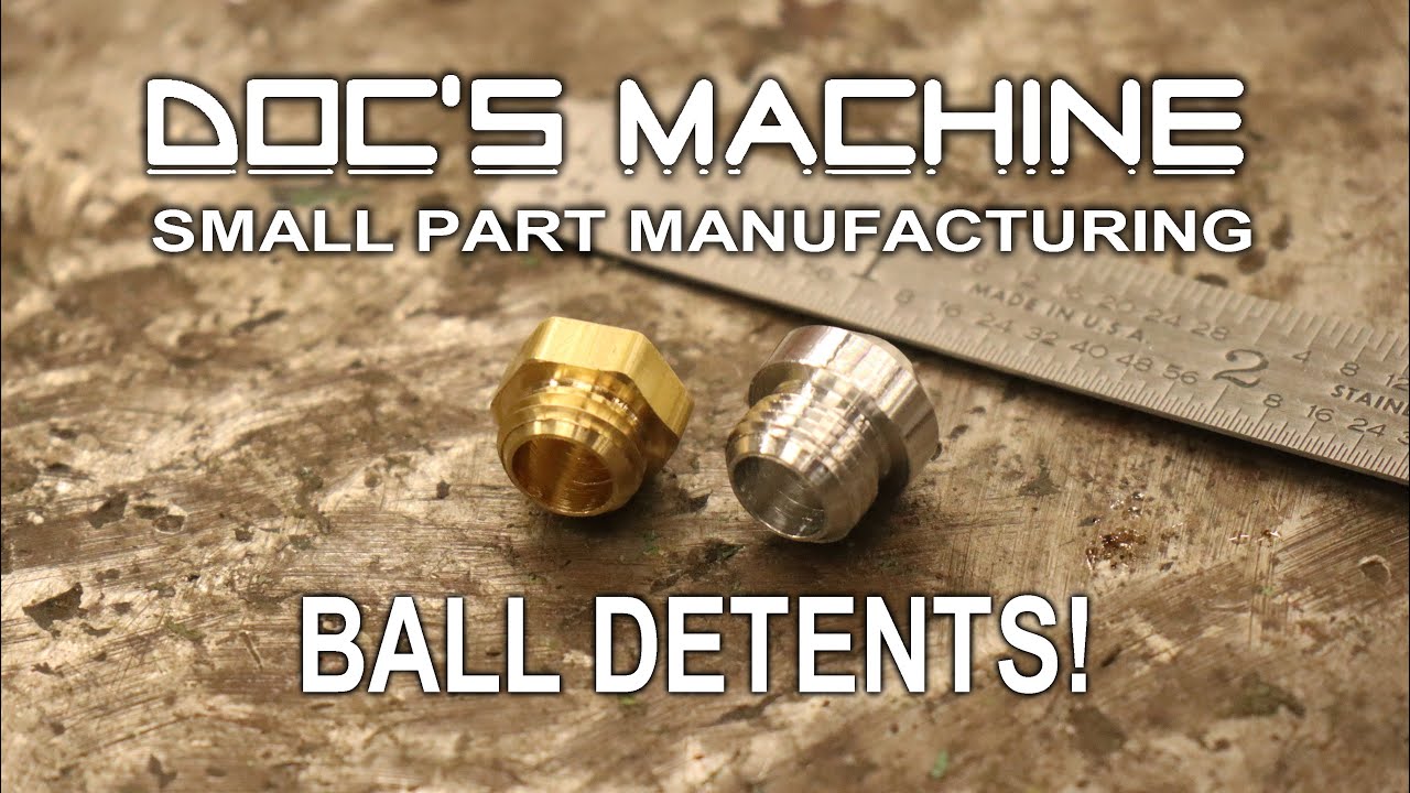

            I have baskets full of tooling for these machines, and I still have to make or modify something almost every time I gear up for a new part.
            Today's tidbit- vaguely related to a customer order- is small bits turned from a long bar. Generally speaking, I can run bars about 32" long in the Omni (limited by the proximity of the adjacent machine ) But when running thin rod that long, you need a spindle liner- a tube that goes into the spindle to make the bore smaller, so the rod doesn't "whip" and cause vibration.
            I don't have any for this machine, so I opted to cut the material I had into somewhat shorter bits, and came up with this idea: It's a chunk of white Delrin, bored to closely match the stock, and threaded to screw into the collet.
            Basically it's a short spindle liner, that'll keep the rod from whipping around eccentrically.
            The other mod was I needed to cut down a parting tool, to have enough clearance for the tool above it.
            Like so (that's it under the pile of brass shavings. )
            Usually I put the parting tool at the top of the tool plate, but I'll be making a bunch of these parts (in a couple different flavors) and I wanted to add a catch bin below the tool. That way I don't have to chase teeny parts all through the machine enclosure. It's not so important on these brass parts, as I don't need to run the cutting oil- but when I switch to aluminum, I will. So the bin will need drains, or to be made out of mesh, etc.- as well as easy to remove and clean out the piles of random chips, etc.
            An alternate idea I was thinking of was just a chute, that the part rolls down to a basket in the floor of the machine, maybe held in place with a magnet.
            Also trying to think of a 'universal' kit- not one that will only work with the current parts.
            Anyway, after wasting a few parts' worth of material getting the program dialed in, I was able to get a small trayful made, before it was time to bag it for the night. (Meaning about 10:30. )
            I'll run the rest in the next few days, and the parts still need some finishing work, buffing and tumbling, but if course I assembled a few for fitting and testing:
            Yep, solid brass 'Cocker detents for those of you doing the 'nostalgia build' thing. A customer ordered a small batch, and as soon as these are done, I'll be offering them up to you lot as well.

                  Latest video: Making ball detents in the turning center:
                  As noted earlier, I made a run of brass 'Cocker detents, but the main reason I tooled up the machine was to do a good sized batch of early-gen Angel detents. Petty sure I'm the only one still making those, and I ran out of my previous batch. And, due to my world-renowned poor planning and world-class procrastination, I wasn't able to get a fresh batch going before I sold out.
                  No worries, new ones are on the way!

                    Great video, always interesting to see how things are made. Thanks for posting them.
                  • DocsMachine
                    DocsMachine commented
                    Just keep in mind I'm not exactly "cutting edge" manufacturing, over here. Any proper manufacturer would be using a machine three to five times faster, and feeding the material automatically.
                    Then again, they also wouldn't be wasting spindle time on these piddly little jobs, so there's that.
